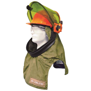

For us, we think we've found an easier solution regarding wearing head protection. We feel the answer is the Solisbury system. No balaclava is needed and because the shield flips up, you get fresh air until you have to close it to do your work. The fact that it has protective cloth flaps that lay over the top of body PPE makes this a good choice for us. See the attached photo. These are not cheap, but they work pretty well.
File comment: This works but it requires the balaclava. The other hood is easier to use.
File comment: We use this hood
Salisbury-Premium-Lightweight-Lift-Front-Hood-300x300.png [ 68.73 KiB | Viewed 4590 times ]

Great option. I have tested them for Salisbury. But there is still no IEC standard. They might have EN testing on them but that should be verified.
