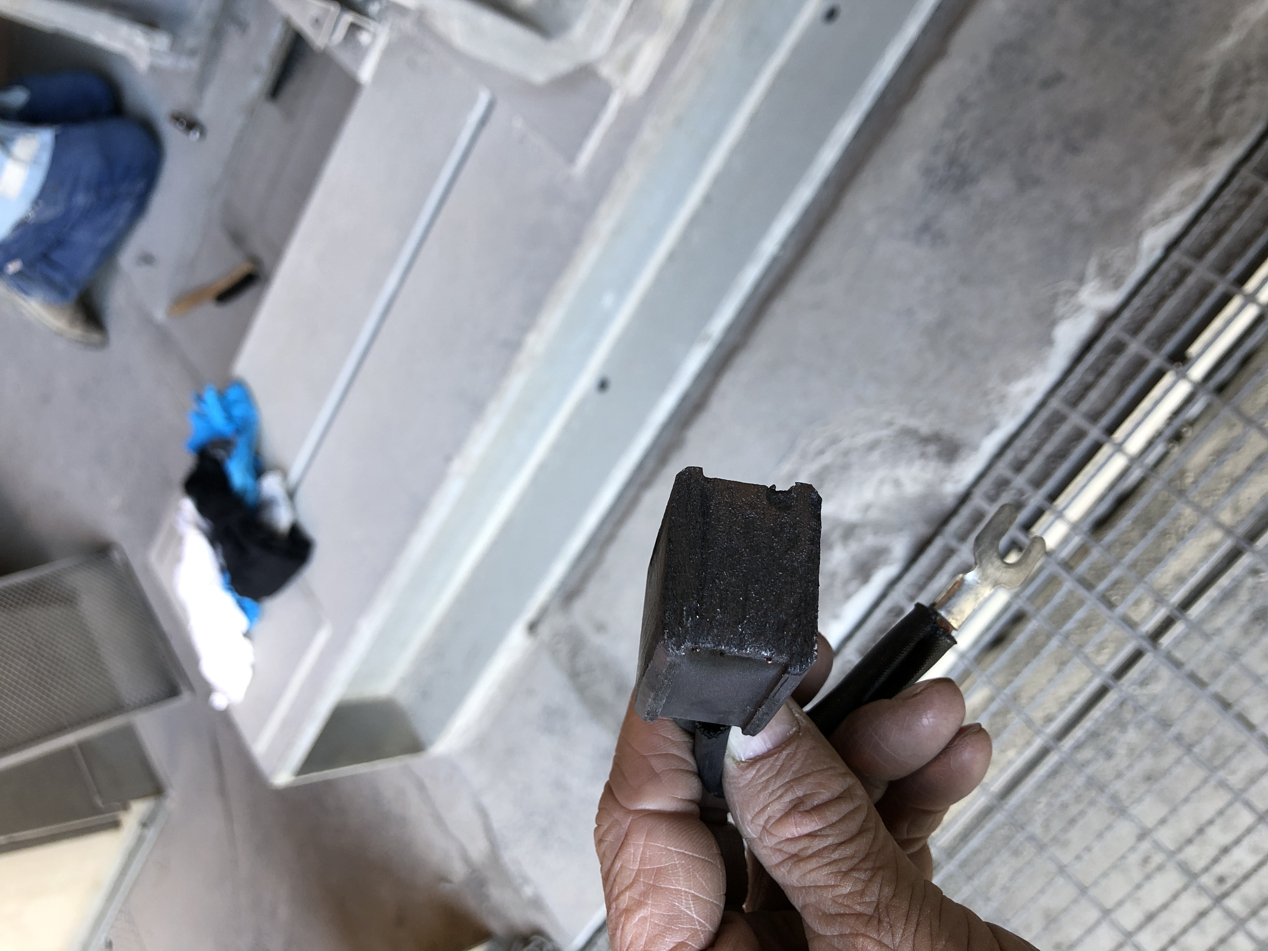

We have a 4160 V, 2530 HP Slip-Ring motor that had an arc flash event during start up. Apparently this they had a similar event with this same motor about 7 yrs. ago. I am assuming that we had a gap between the ring and brush that led to the arching a had also acquired some carbon dust build up.

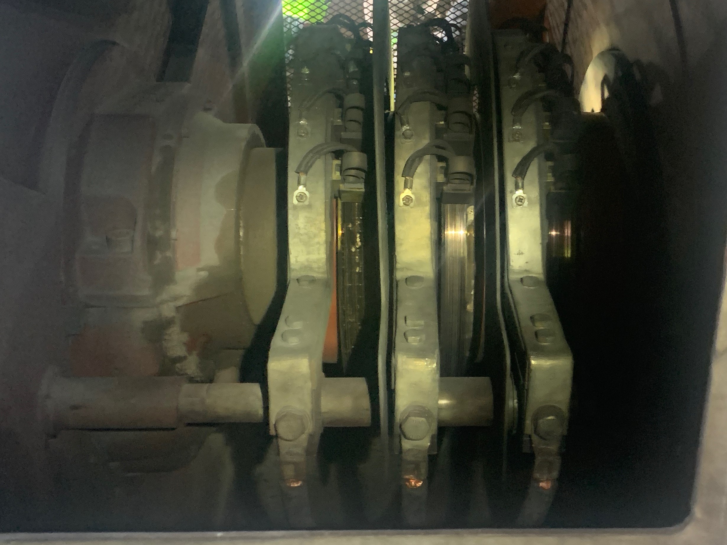

Attached are a few photos for reference.
File comment: Brush
File comment: Slip Ring

Check to make sure the brush-holder springs are maintaining correct pressure on the brush and that the brushes are not binding in the holder. Also, there is an optimum amperes per square inch current density for particular carbon formulations. Check with your brush supplier/manufacturer to see if your operating conditions are within spec for the brushes you have.

At start, the would rotor open circuit voltage on such a motor might be ~2kV and as such insulation is key. Cleanliness of the slipring box requires routine atention in brush dust removal. Brush lifting & slip ring shorting devices can extend the time between such servicing where warranted.
If your motor starting device (resistance steps / LRS / other) did present an open circuit then the situation is exacerbated.
Certainly brushgear maintenance or issues with brushes hanging up due to dimensional tolerance issues are not uncommon.

We are learning more that the brushes where the fault took place do not move easily, not sure if this is a result of extreme heat from two known flashes. We have the found the specifications for the spring tension and looking to test ours. We have also learned that the motor manufacturer recommends electro graphite brushes, where we using metal graphite brushes. Not sure if these were causing excess carbon dust or if they have a higher current density than the recommended brushes?

Thanks GBISON, We are making sure we are doing better inspection of the slip ring box while the motor in down as well as looking into slip ring maintance/repair.
