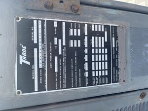

I want to model an RTU (rooftop unit) HVAC in SKM. As per the nameplate, it has both motor load (constant KVA) and non-motor(constant Z) load. Is there any option in SKM to model both motor and non-motor loads together like a lump load? I have seen this option in other simulation software. I wanted to confirm this in SKM.

Why not just connect a load and a motor to the same bus? It's effectively the same thing.
