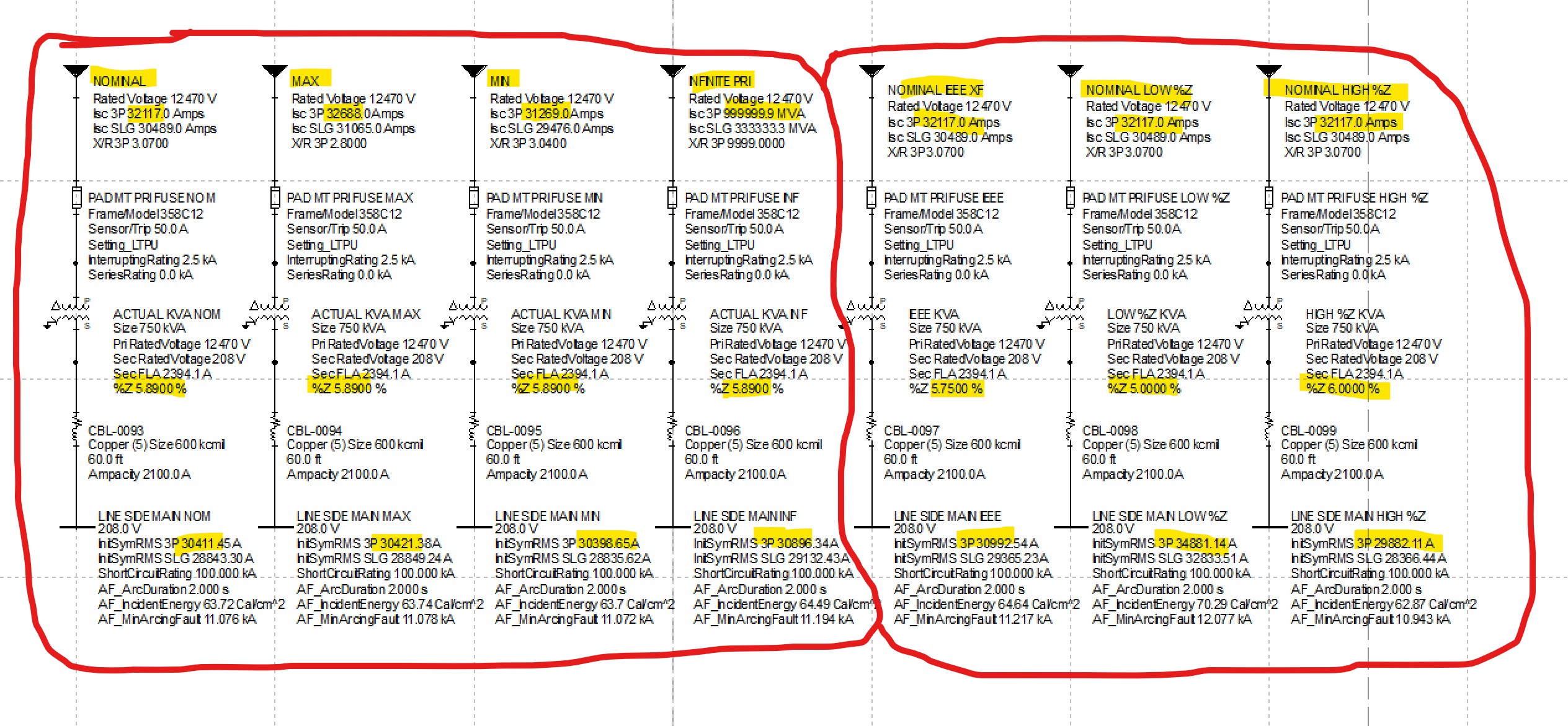

I found the example I was referring to earlier. Not exactly the parameters I described in the experiment, but the message is the same. The primary Nominal / Max / Min are straight from a utility company actual job as is the 5.89 %Z. You can see that only makes a few hundred amps difference on the secondary, even going to infinite bus on the primary.
The example of changing the %Z on the transformer makes 5,000 amps of difference. I think it is more important to get the actual %Z than the actual primary AFC, but both are still important. If you are doing a new design and want to make sure your equipment has adequate interrupting and/or withstand ratings I highly recommend using infinite bus primary and a low %Z. For arc flash purposes, I recommend being as accurate as possible for as-built conditions.
