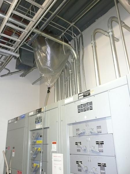

Arc Tolerance
I use SKM and have similar situations. Using the default options (85%), most of AF amps were cleared by the instantaneous settings and yielded Cat 0 values. However, when viewed as TCCs (Time Current Curves) many AF amps were very close to the instantaneous.
In SKM, Arc Flash Evaluation, Options, Arcing Tolerances, I changed -15% to -20% or 25% and re-ran the study. The new values were either Cat 2 or Cat 3.
I created a Custom Label that has both the required calculated Incident Energy value (using -15% Arcing Tolerance) and the requirement to use a higher PPE. I also modified the "Flash Hazard Boundary" similarly.
You can put anything you want on the label, as long as it includes the basic requirements.
